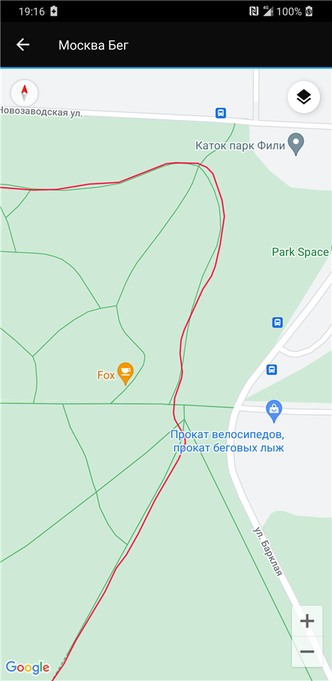

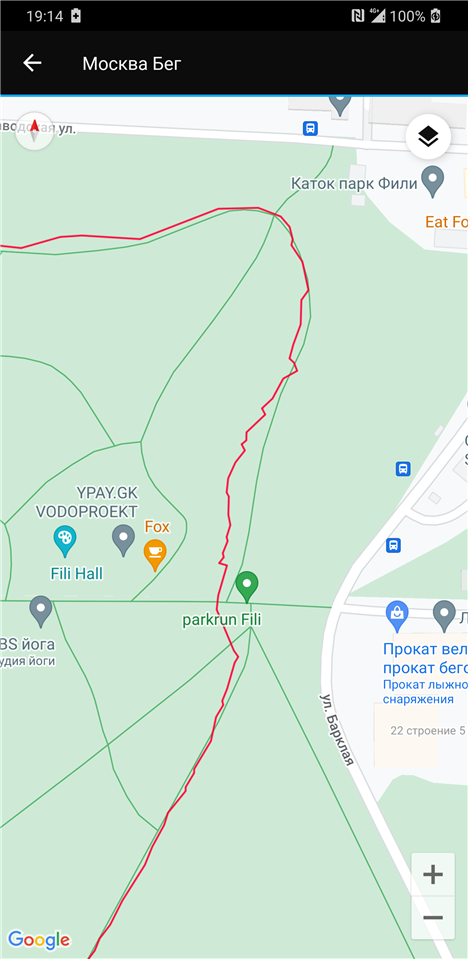

Hi guys!
After update 12.23 gps track has been disappointingly inaccurate.
Before update gps track was incredibly smooth!
What do you think?
Maybe opaque autumn clouds?
On pic below: after update and before.

Then I’m not crazy. I am losing my mind, to understand, as it is possible, that a watch of this kind, does worse, than a watch, much cheaper and with less GPS systems! Today I tried again, with all systems…
I suspect we're seeing two different things here.
There is undoubtedly GPS jamming in evidence in the tracks recorded in Moscow. They're accurate until they pass close to certain landmarks, then become…
All my tracks from the purchase of the watch to the update 12.23 were incredibly correct. The Russian special services jams the gps signal in Moscow, but in this case gps track looks different, this situation well known to every taxi driver in the centre of the city.
I don't think that all user of this thread (not only from Moscow) suffer from deliberate state-sponsored gnss disruption. Few posts above user from Italy said about the same distorted track.
There is disappointed user from Scotland with the ugliest gps track i've ever seen (software 12.23!) https://forums.garmin.com/sports-fitness/running-multisport/f/forerunner-955-series/307521/955-gps-is-rubbish-for-running-and-swimming-can-i-return-the-watch
Come on, what is extolled as a holy grail is not. The track itself, in some cases seems to be very precise, but at other times, it loses precision, and not a little, the track goes, in very different places, from where I passed. If it had been a watch a few years ago, without all these systems, without multi band, then, you could really settle, but with this technology, garmin shows, like the Holy Grail, gps navigation, So don’t you think we should expect something, or much more? Then by activating, all systems, plus the multiband, the clock consumes a lot of battery. Therefore, such a consumption, should be justified, otherwise we go back to the old models, we save money and time to worry, that what we bought, at a high price, works as it should work
