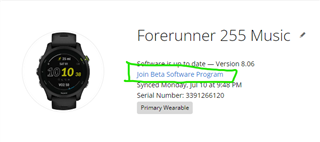

Software version 15.19 has been made available, so anyone who syncs through Garmin Express should now be able to update their unit to that version. If you would like to enroll in our Beta Software…
