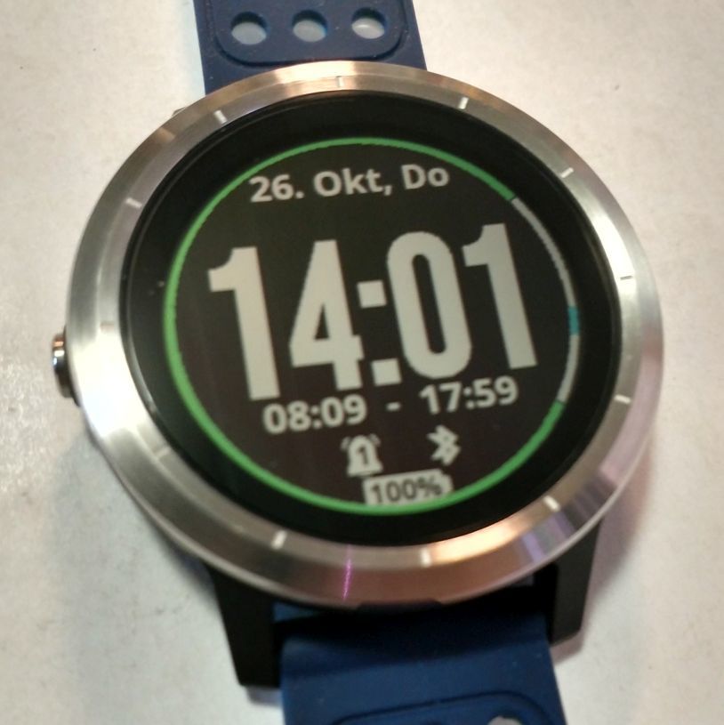

  • Thank you for this watchface, and especially adding sunrise/sunset complication. After getting the first GPS fix (going outside, starting the 'Navigate' app on my Vivoactive 3) it works well.
    community.garmin.com/.../1267010.jpg
