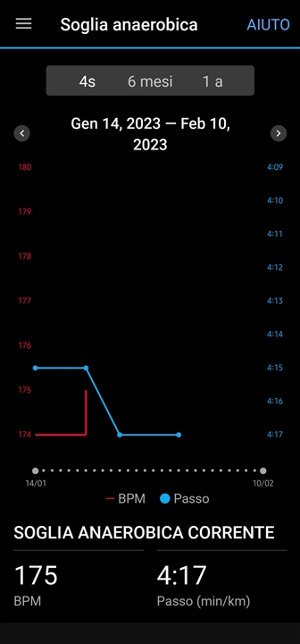

Something strange today which return me to old problems, training effect... Switch to Max hr instead of lactate threshold because of no detection problem and today's run in zone 2 results in treshold effect...
What is your maximum heart rate? It is clear from the pictures that you have zones set outside the Garmin standard. You reach the threshold when you spend more than 20% of your run above 80% of your maximum heart rate.
