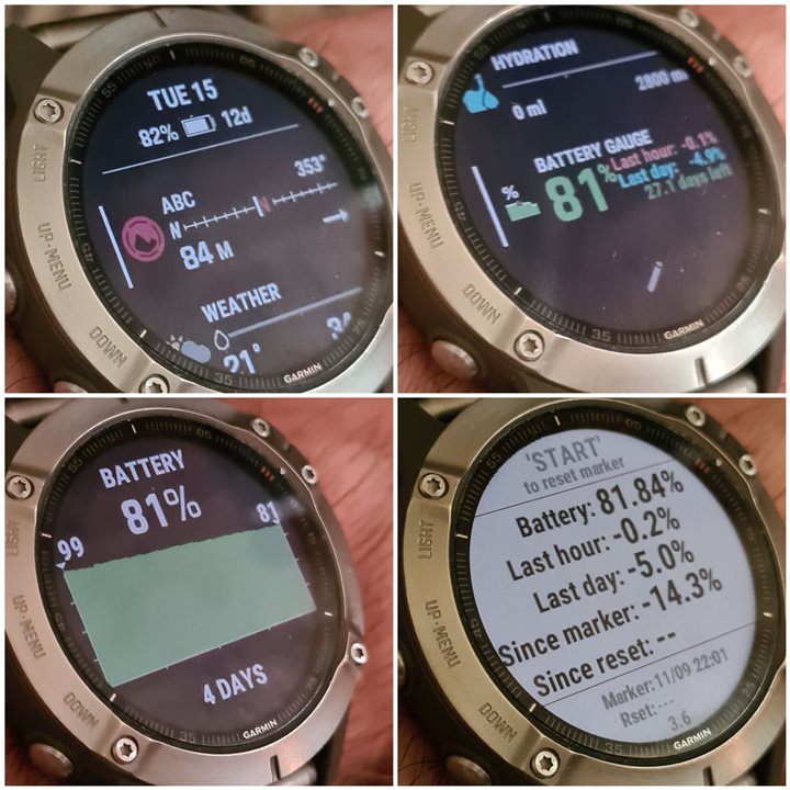

  • Just to update on my experience.
    After going back and forth with various firmware and scrutinising logs inside the watch, I came to the conclusion that the battery was at fault.
    It's seems to be very coincidental that the battery has gone "soft" at the same time as the update, but I have no evidence to say otherwise.
    To resolve this for good is spoken to Garmin Australia whom seemed to be very helpful at first. However, having submitted my usage logs to them I heard nothing for a over a week. And as my warranty was about to expire, I decided to speak to the retailer (Rebel Sport) about possible exchange.
    To my surprise and delight they had no qualms about it and sorted out a swap for a replacement unit. Full marks for customer service.
    Ten months of battery life, however, doesn't fill me with optimism.
