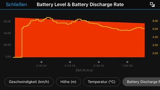

did a 1,5 hr trip with my F6xProSolar yesterday with fw 8.76. Device was on the bike mount in bright sunlight. Navigated to a saved navigation, no bt, no music, temperature sensor connected, no other sensors, gps only and the map page on the display for the whole ride. Got a battery consumption of 6,15%/hr. That is way too much. I know, that the map page is draining a lot of battery, but normally I got about 4%/hr.
