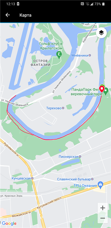

Hi guys!
After update 12.23 gps track has been disappointingly inaccurate.
Before update gps track was incredibly smooth!
What do you think?
Maybe opaque autumn clouds?
On pic below: after update and before.

Then I’m not crazy. I am losing my mind, to understand, as it is possible, that a watch of this kind, does worse, than a watch, much cheaper and with less GPS systems! Today I tried again, with all systems…
Hi Kevin, after updating to 13.21 nothing changes:
Run on 22.11.22 at 19:08 SW:13.21 GPS: Smart; GPS-mode: auto-select, Problem at Minute 1:30-2:00

There are not any changes. GPS fluctuations are still significant, therefore pace and other metrics dependent on GPS are incorrect. I'm going to hike in mountains and i need accurate navigation, i will navigate with my absolutely accurate, reliable and robust Oregon 750 instead of 955.
I also encountered such extreme path deviations, not in every run, but from time to time.
My previous FR245 and Fenix 7S never had such extreme deviations that makes a run more than 400 m longer than expected.
Pace is also completely wrong. For such wrong GPS recordings I don't need a 500€ sport watch.
After analyzing the GPX file of the run with errors, one can easily see that twice some data points have not been recorded - firstly 13 seconds are missing that create the jump to the right, and a few seconds later 62 seconds are missing that create the jump back to the left on the correct path.
It seems to me that the GPS chip software had some problems and rebooted... just a guess.
(GPS Recording FR955 V14.20, GPS V2.37, All+Multiband, every 1 sec)
