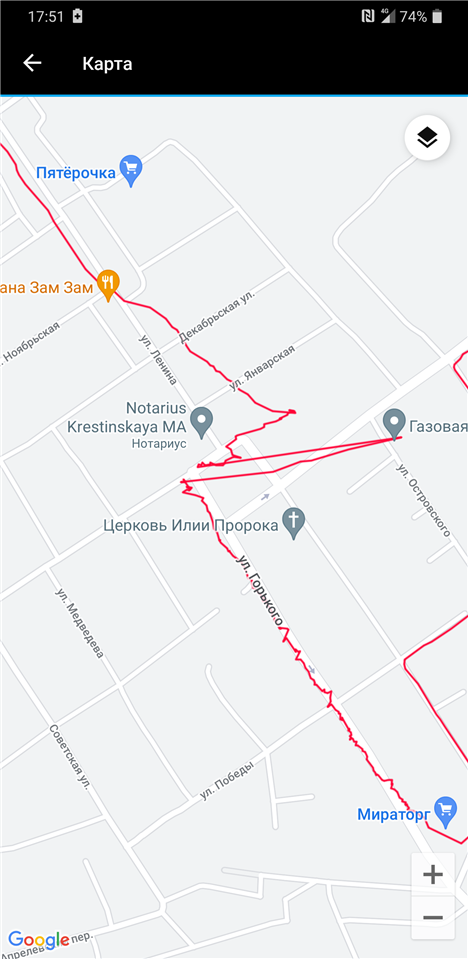

After update 12.23 gps track has been disappointingly inaccurate.
Before update gps track was incredibly smooth!
What do you think?
Maybe opaque autumn clouds?
On pic below: after update and before.
Hi guys!
What do you think?

I suspect we're seeing two different things here.
There is undoubtedly GPS jamming in evidence in the tracks recorded in Moscow. They're accurate until they pass close to certain landmarks, then become…

Russia apparently jammes the GPS signal: gpsjam.org/
I just confirmed my suspicious! The problem started after they changed GPS software version from 2.35. The problem started with GPS 2.37 for bot Fenix and Forerunner lines. But 2.42 didn't fix the problem.
I backdated the F7 firmware to stable 9.33 which uses GPS 2.35 and all tracks are smooth and straight again!
There is undoubtedly GPS jamming in evidence in the tracks recorded in Moscow. They're accurate until they pass close to certain landmarks, then become massively inaccurate.
Something different seems to be the problem for the Brazilian tracks (which is fixed by downgrading).
