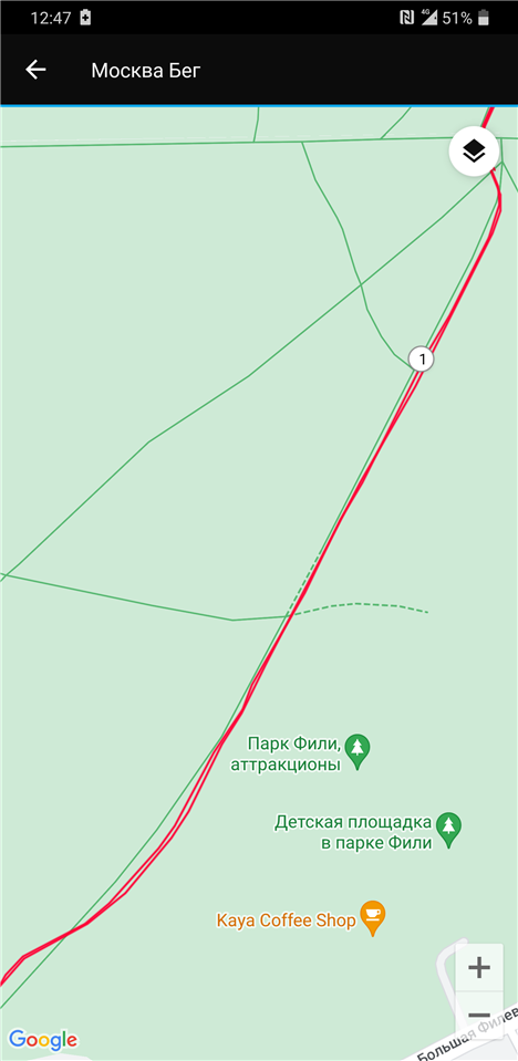

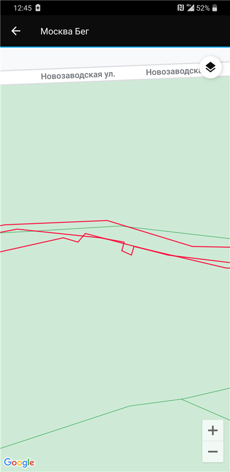

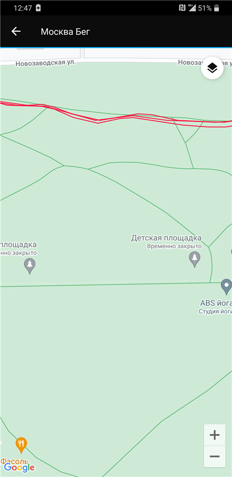

Hi guys!
After update 12.23 gps track has been disappointingly inaccurate.
Before update gps track was incredibly smooth!
What do you think?
Maybe opaque autumn clouds?
On pic below: after update and before.

Then I’m not crazy. I am losing my mind, to understand, as it is possible, that a watch of this kind, does worse, than a watch, much cheaper and with less GPS systems! Today I tried again, with all systems…
I suspect we're seeing two different things here.
There is undoubtedly GPS jamming in evidence in the tracks recorded in Moscow. They're accurate until they pass close to certain landmarks, then become…

Sample of a track from yesterday. This was with GPS set to "All + Multi-Band".
Your pace of walking is absolutely insane!
