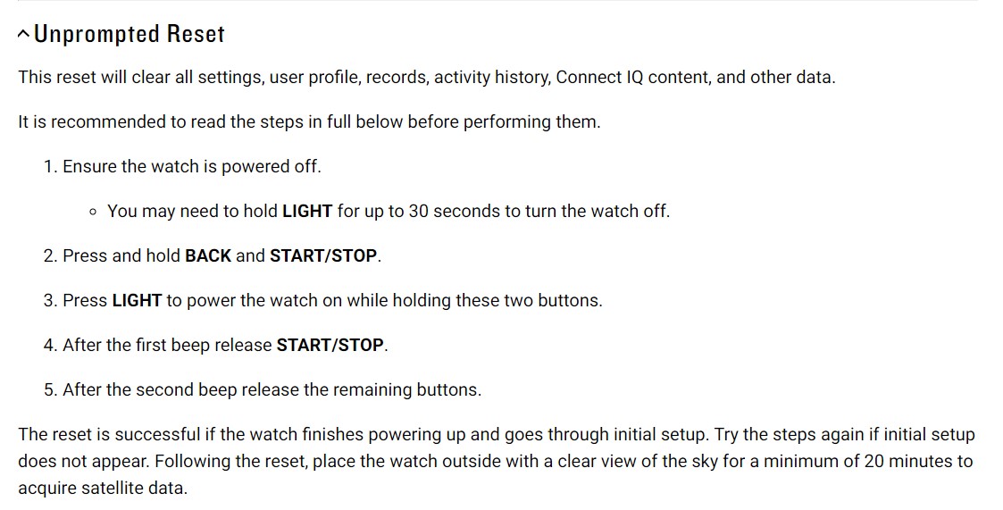

- when restarting the device - it just gets stuck on the Reset screen (the same issue as described here)
- sometimes back button does work after I manage to skip the Reset screen but goes back into some bad state after a couple of minutes

  • I am sorry to hear you are experiencing buttons concerns. For this, there are a few steps we recommend trying initially.
    • Ensure the watch is on the latest software version using Garmin Express.
    • Try cleaning the buttons with the following steps:
      1. Submerge the watch in warm/clean water for 10 minutes
      2. Remove the watch from the water
      3. Press the buttons repeatedly
    • If the issue continues, you can also attempted a factory reset with these steps, if possible.
    If this issue continues, it is likely the watch will need to be replaced. For this, we would recommend contacting Garmin Product Support.
