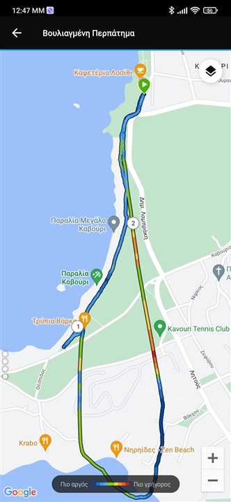

Not so sure about that, I had an issue mid last week like a lot of people, went for a walk Thursday night which was fine, but just went for a short walk today and the GPS lost itself half way through the walk.
The thin red line is the rough path taken, goes haywire half way. Had a green GPS fix before leaving the start point. Start and Finish in same location. I’m on 22.10 on a F6x Pro.

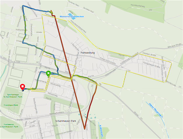

My wife’s Fenix 6s had the worst GPS track I think I’ve ever seen this morning. Not even close to the route she ran on, ok for first 500m and then 9.5 km of routes more than 0.5 km away from where we actually were. Not just shifted either, the shape of the route was completely off and directions all over the place. Software 22.10.
No it wasn't. F6 GPS was never really good, but this is now just unusable. Yellow line is my actual route, the other line is what my F6 thinks I was running.
