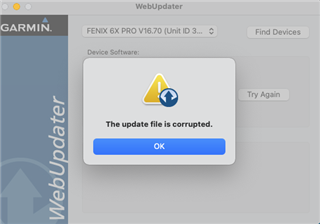

  • I have exactly the same issues as we confirmed as well as the about page with all the versions the same. I haven't had a chance to try the Web updater yet but the only way to fix the watch I believe is to update to a fixed version that hopefully manages to fix the corrupt files.

  • Hey Chris my watch auto updated to 16.70 but the WiFi is still stuck on 655. Do you still recommend I try web updater to see if it can reflashed?
  • Same here. Updated automatically. WiFi firmware still at 655.35
  • I am holding out on the automatic update by turning off automatic update, but Webupdater keeps saying it already has the latest firmware (16.60). Will try again when the 16.70 rollout hits 100%, but somehow I am not optimistic.
  • Especially considering that this update (16.70) hasn't resolved the wifi firmware issue - I would tend to agree with you. Woke up this morning to 16.70 automatically being installed and that issue (core issue) wasn't resolved.
  • Same, first thing I did was to check for WiFi networks. Nothing, checked the patch notes but nothing to do with garmin express or WiFi.
  • I am sorry your Wi-Fi is still wrong. At this point, we recommend your warranty replace your watch. I am really sorry. There is only so much you can do to get the software to take and with whatever went wrong, your Wi-Fi is not willing to correct.
