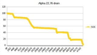

  • Still no crashes although battery life has been abysmal since I moved to the Alphas.
    I got 2 days with 22.75 and about 5.5 days with 22.76 with barely any use (no phone connection)
    Or to put in another way, I had to recharge twice in under a week. 22.76 died during a non GPS activity that I started with around 17% as shown in the graph below
    (For outdoor team use for graph below: samples = 48755, gtime 1027456876 to 1027944125)
    So I have pretty much screwed myself as in my experience when this happened with 19.20, its not recoverabe (unless I can still flash back to 15.20)
    Ironically it has NOT crashed...but battery life has been destroyed.  Large post activity drain.
    forums.garmin.com/.../large-battery-drain-100-to-5-in-48-hours
    Really wish it was possible to get the last non public 19.30 baseline from 2021 as that was super stable with no altitude or sleep 'improvements'. I'd be happy to 'freeze' on that codeline personally. These recent firmware changes have not been worth the loss of stability and now battery life for me.
