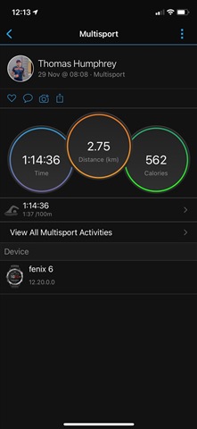

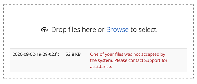

Seems to happening with increasing frequency now. As soon as I ended my swim the screen went straight to the blue triangle screen. I've also had times in the past where it shows up in Garmin connect as a multisport event - with just a swim. Garmin Connect, Strava and TrainingPeaks don't recognise the file. Garmin support have not been helpful over email. Going to call tomorrow.
I cannot click into the activity data on the watch and the swim icon just has a dotted line icon instead of being filled in and blue.

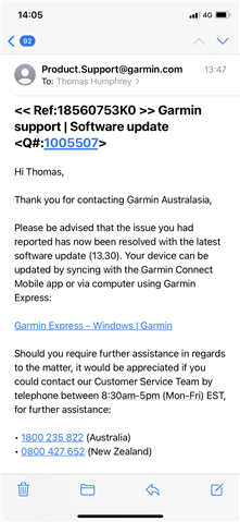

  • FYI everyone. Looks like a fix in the latest software update  I’m on four successful swims in a row. Only took them 7 months to patch
  • From the international website, there is no details about any bug fix for versions 13. 10 to 13.30100.
    Changes made from version 13.00 to 13.30:
    • Improved syncing of data with Garmin Connect Mobile.
    Hope that the issue is resolved but I'm sceptical.

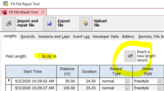

    Also for those whom may be interessed ...... If you're on Strava you can still try to download the file directly from the watch to Strava (via the USB cable on the computer) ; I did it and could retrieve some  incomplete data... Intervals were correct but not distance or  total time.
