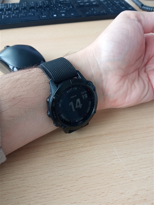

  • The normal position of the watch on the hand, and the position of AndersB in the last post. Here you can see exactly which side of the road i am on.
  • Nice! The screenshot to the right is really good. Did you also have 12´oclock pointing towards the hand like in my picture?

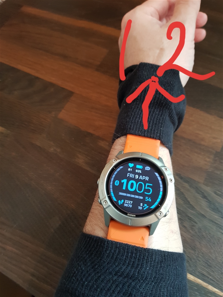

  • Gave this another go with the watch worn on the inside of my wrist with 12 o'clock pointing up. I used GPS+Glonass and every second recording and waited for a few minutes before starting.
    https://connect.garmin.com/modern/activity/6572961355?share_unique_id=10
    This seems better than the usual abysmal tracks I get- it will be interesting to compare this with my replacement that is arriving tomorrow.

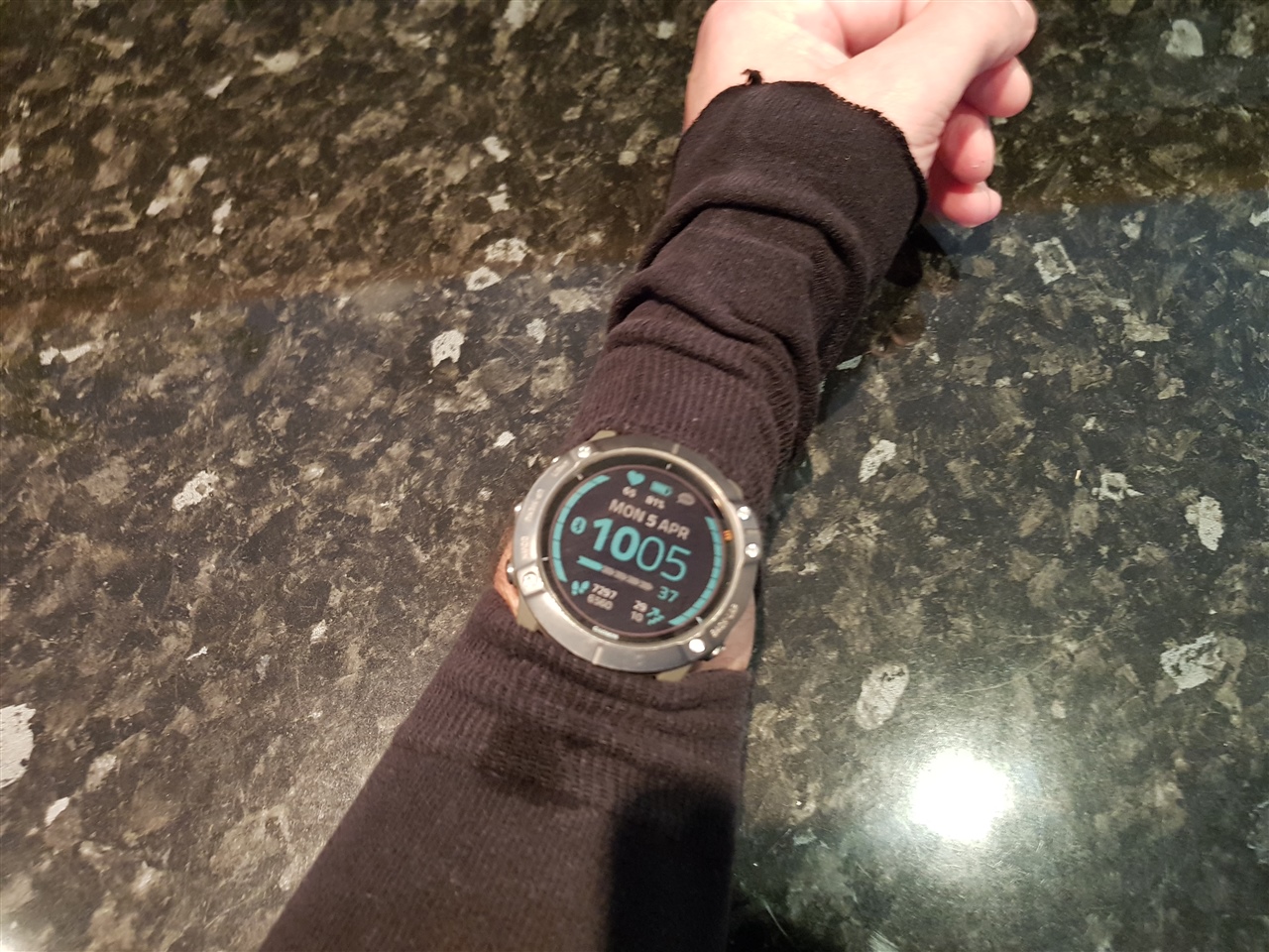

  • Today I ran with the clock again as set by AnderB.
    The pace was great as was the trail of the track I was running on.  I am showing examples from Strava to see my last 4 activities. This one is the first in a row today.
    This one is the first in a row today.  I increasingly believe that the problem is in the design of the watch and its antenna which is placed on the wrong side.

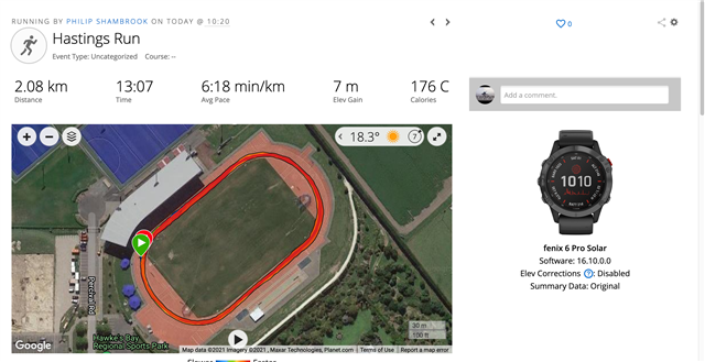

  • I did something I haven't done for years - ran around a 400m track. I wanted to compare the Track Run activity with the Run activity. Watch was worn in what I guess would be termed the 'normal' position on my left wrist. Hard to see the difference. Both are 5 laps in lane 3.
    I don't see any problems.
  • On my latest tests i have had the watch like this. 12-óclock pointing towards the hand. Seems to getting better GPS trace but maybe less accurate pace. Will test some more.
