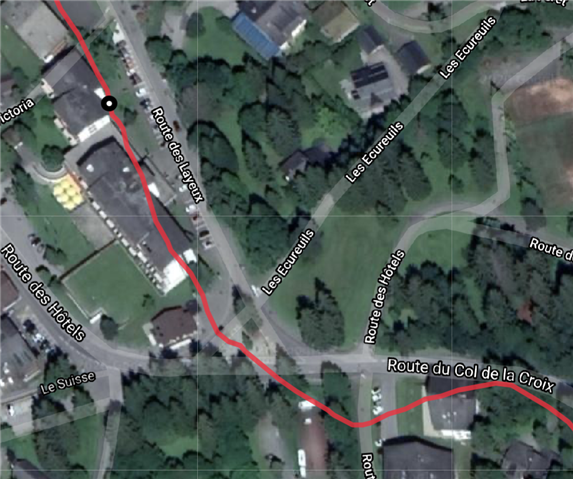

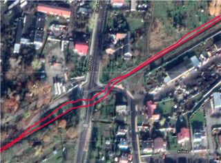

Hi,
I am experiencing problems with GPS accuracy. On certain occasions it seems that the signal is lost and the precision is lost by more than 4 meters.
Currently i hace this config:
  • Data recording  every second
  • GPS + GLONASS
  • 3D speed On
  • 3D distance On
I've been reset several time the watch and the problem persist. and doesn't seem a problem with the tree or the weather. There is not any building nearby or great structures that can obstruct the signal
Please take a look
https://connect.garmin.com/modern/activity/4933721083
Hi Again.
Same problema. Only GPS config.
I'm very disappointed with the precision of the watch. It's obvious that are more than 10m of gap

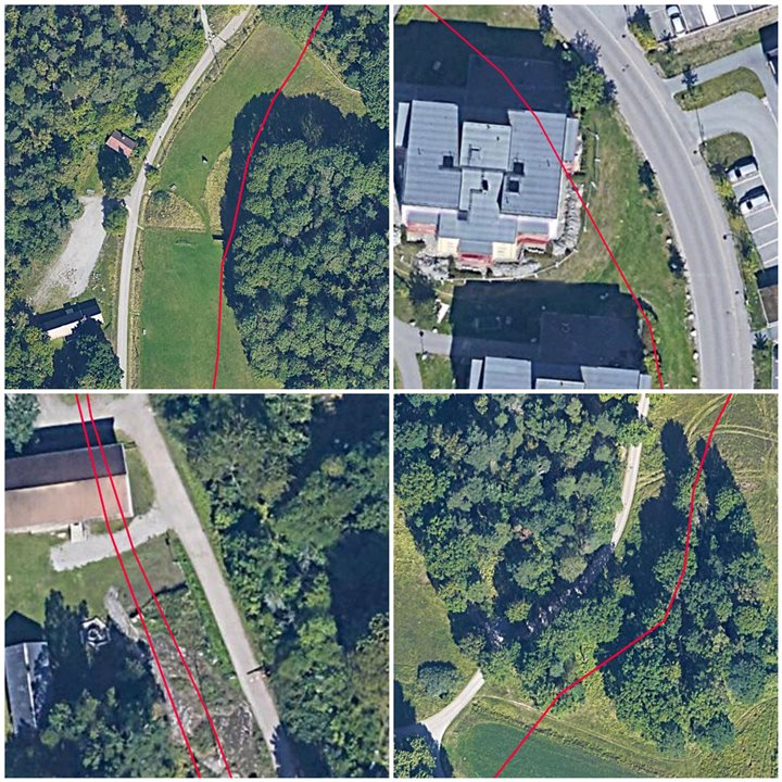

    But, looking into some of the pictures with the track in this thread, my GPS track was never as bad as this (even on Fenix 5s plus). Looks that some the people have serious problems with GPS and this may or not may be a problem with Fenix. This may be a problem just with the place where these people run (noise, a lot of buildings etc. even weather have impact on GPS signal).

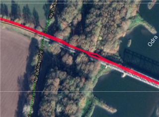

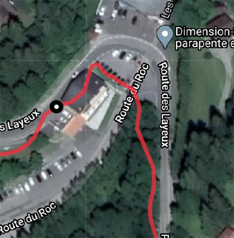

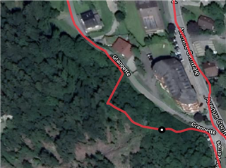

    Is different each day, some of my good and bad results with GPS on F6x:

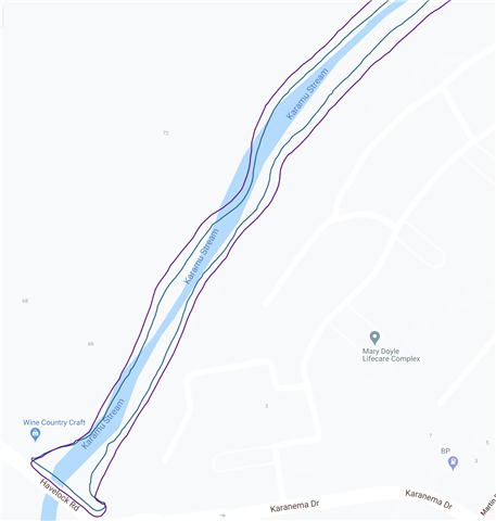

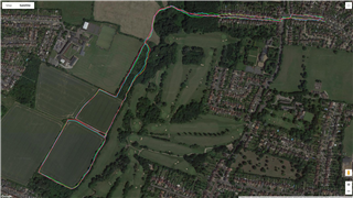

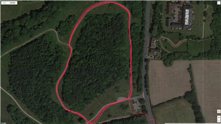

  • A couple of us have mentioned in the past that there is a need to be careful commenting about the tracks created by Garmin and drawn on the map and their relationship to the track shown on the map. Basically, the track on the map is not necessarily correct. Here's an example from tonight's run. The first is the map on Garmin Connect:
    The second is the map in DC Rainmaker's Analyser, which gives me wet feet.
    I'm not suggesting for one moment that this explains the problems that some people are having with their GPS but just putting it out there that sometimes we cannot always rely on the map being accurate. BTW, the second map is a run tonight with two F6 watches, one on each wrist, while the upper map is the Garmin Connect map of one of the watches on the same run.

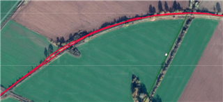

  • I'm one of the happy owners of a 6x.
    From start when I bought it in October, I've compared it to my Polar V800. Its accuracy has been a lot better than my old 5x. Both gps and elevation. Never using the OHR, by the way.
    Lately I get more and more gps tracks from my 6x that beats my V800.

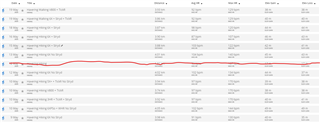

    See what you think. Here are my 12 latest runs:
    (V800 green, 6x red, some details about settings and sensors in Notes section. A lot of bad hr-data due to a over-used strap that I've not been able to pin-point)
    analyze.dcrainmaker.com/

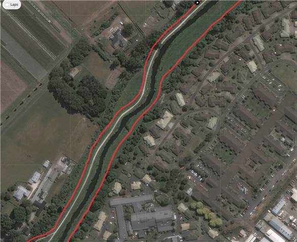

  • Map alignement is maybe not perfect indeed. But when you run back and forth on the SAME track and there are 20m between the two lines, it's not a map pb :)
