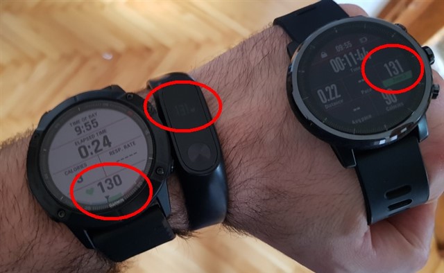

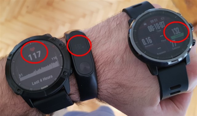

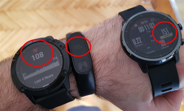

    Left to right: Garmin Fenix 6X Pro, MiBand 2, Amazfit Stratos (connected to Polar H10 chest strap).
    Results:
    After starting activity on Garmin:

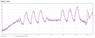

  • This is one example of my OHR testing with Fenix 6x Pro Solar.
    I started the workout with OHR, then switched to HR strap and at the end switched back to OHR.
    Initially OHR was 20-30 beats too high.
    In the middle the HR strap is correct.
    At the end, after disconnecting HR strap the OHR shows 20 beats too low and then after a small stop it went 20 beats too high.
    This is the same run recorded with FR945 using HR strap.
    I reported this to [email protected] as suggested.

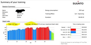

    Today I was at my indoor cycling training and I have my Fenix 6 pro on hand with WHR and Suunto HR Strap on screen in my fitness club. My watch band was fasten really tide.
    I'm very dissapointed how bad is F6 WHR :(
    Looks at screens below, it's the same ride from today, on fenix it looks totally different, most of time Fenix was around 40-50 bpm lower than HR Strap! During whole workout HR on Fenix jumps suddenly from 70 bpm to 120 bpm a then down to 80 bpm. It's ridiculous!
    Avrage HR: Fenix6 91bpm, HR strap 146bpm
    Max HR: Fenix6 130 bpm, HR strap 167 bpm
    Before I had Fenix5 and WHR was really good, now I paid additional 300Euro for this SH*T!
    Shame on you GARMIN! FIX IT!
