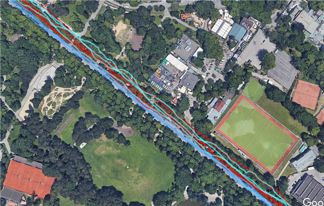

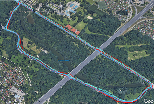

  • My yesterday's 14km-race in Vienna (officially measured 7km-laps) led to a 13,25km run! That means fenix  6x pro is 5,35% below! (GPS 2.7! - didn't fix any accuracy problem)
    The accuracy of the fenix 6x-track is not very bad in this case and calculating the distance out of the gps-track gets a result of 14,1km! Differences between the recorded second-intervals are up to 295cm (per s!!) You can see that the deviations are not distribtuted randomly. They are increasing and decreasing. These two laps do not show any coincidence. First lap is much better than the second one.
    The accuracy fenix 5x is much better than the fenix 6x sapphire, but V800 is still more reliable than both:
    V800 (dark  blue); fenix 5x (light blue), fenix 6x sapphire (red)
    How can I share gpx-tracks?
  • The deviation can be different between the two laps since the satellites position will be different over time, and it can make a significant difference, don't you think ?
