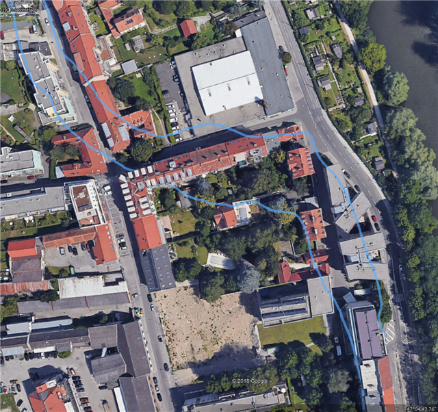

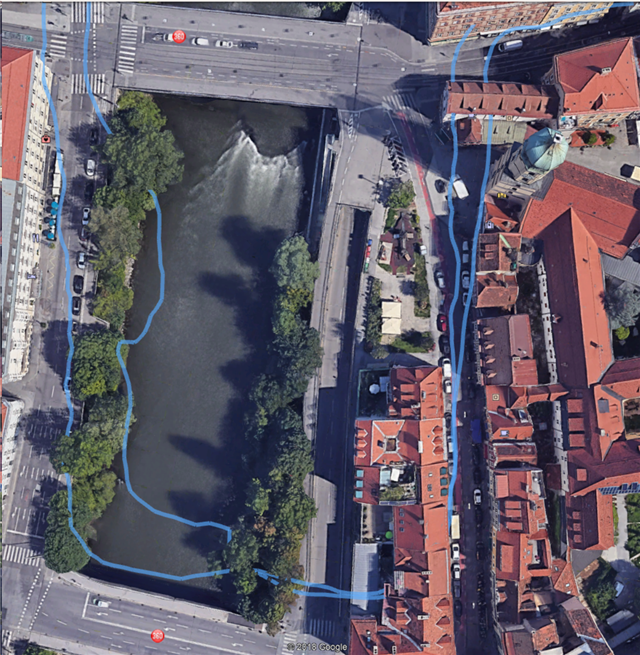

  • I totally agree - my silvester-race of 10km - distance got a result of 9,28!!! km. Analyzing the fenix 6x sapphire gpx-track I got 9,69 km and !! the GPS-track ist (under perfect weather conditions) poor poor poor!
    2 laps á 5 km:
    first picture: from right lower side to left upper (should be at the road all to the right!)
    second screen shot: also from the right (upper) side to the left (upper) side
    first lap was about 4,7km, the second one about 4,5km!
