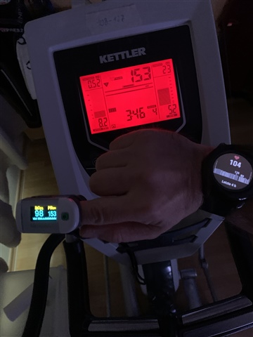

    Yes, me in an activity too. But allday tracking is a mess. The heart rate indicates 30 beats too low. If I have 120, the watch shows 90. This falsifies all calculations based on this, such as calorie consumption and intensity minutes. And Garmin hasn't managed to fix it for 3.5 months. They have a working code in the drawer. Because the first firmware at the end of August went great. No problems with too little HF.
