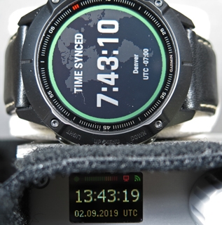

    Here's what it looked like compared to my time reference after an additional Sync using GPS:
    Time was most certainly NOT synced!
    Then, I did what I did yesterday to fix displayed time - I synced with Garmin Express on my PC: time was finally displayed correctly within one second of reference.

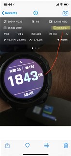

    I compared the situations reading the image EXIF timestamp inserted by iPhone when a photo or a screenshot is taken.

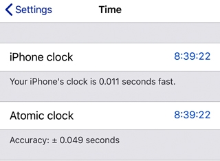

    iPhone sync with NTP (Network Time Protocol) time from the network.
    this is the time displayed and synched in iPhone:
    a screenshot of 'Emerald Time" app (one of the only that display seconds) shows perfect sync of iPhone with the NTP servers.
    6X pro is off by one second - a screenshot of the photo taken and the timestamp of the phot from EXIF
