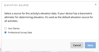

    > Ok, GC still has the option to not use corrected data
    Yeah I think the option was only removed from the app.
    It's par for the course that the app version of a service often has fewer features than the corresponding website. (These days it's unlikely there's a website at all, for a lot of services/tools newer than ~10 years.)
  • Ok, GC still has the option to not use corrected data

  • Elevation from GPS can be way off, based on where you are. Especially when it comes to ascent and descent
    This is why when an activity is synced to GC on a device without a baro, elevation correction is applied by default.  That used to be something you could turn off for an activity, but it seems that option was removed.
