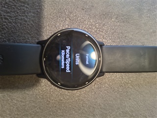

A user of one of my apps reported that they can't change the elevation unit from feet to meters. I told them to do it in the system settings (my app uses DeviceSettings.elevationUnits). But it turns out that Garmin left that possibility out from vivoactive 5.
The only settings (both on-watch and via Garmin Connect) are:
distance, weight, height, temperature, pressure.
Note, it's not a mistake, it's height, with cm or inches, and not elevation or altitude that's supposed to be meters or feet.
This is vivoactive 5 with FW version 14.15
Yes, there's no barometer in va5, but it doesn't matter, because the watch displays the correct elevation based on GPS, just in feet.
