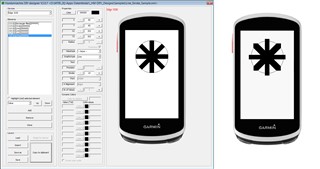

  • This post has nothing to do with the new version of DIY.
    It concerns an observation I made some time ago.
    A line with "heavy stroke" is displayed differently in the designer than on my Edge.
    Just out of curiosity: is it the same for all devices, or is it just the Edge?
    <?xml version="1.0" encoding="UTF-8"?>
    <DIYLayout>
        <Device name="Edge 1030"/>
        <LayoutElement type="1" color="FFFFFF" x="0" y="0" x2="282" y2="470" eletype="RF" valuetype="FX" radius="0" stroke="1" nr_values="1"/>
        <LayoutElement type="1" color="000000" x="141" y="141" x2="0" y2="0" eletype="CR" valuetype="FX" radius="86" stroke="1" nr_values="1"/>
        <LayoutElement type="1" color="000000" x="141" y="56" x2="141" y2="228" eletype="LN" valuetype="FX" radius="0" stroke="24" nr_values="1"/>
        <LayoutElement type="1" color="000000" x="202" y="80" x2="80" y2="202" eletype="LN" valuetype="FX" radius="0" stroke="24" nr_values="1"/>
        <LayoutElement type="1" color="000000" x="56" y="141" x2="227" y2="141" eletype="LN" valuetype="FX" radius="0" stroke="24" nr_values="1"/>
        <LayoutElement type="1" color="000000" x="80" y="80" x2="202" y2="202" eletype="LN" valuetype="FX" radius="0" stroke="24" nr_values="1"/>
    </DIYLayout>
