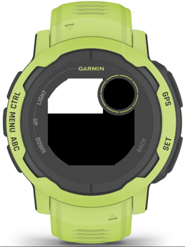

But when I run it on the Instinct 2, this is the result I get:
It is like the screen area is limited to only the superior half and limited by the subscreen.

If I print the values of width and height on the terminal, I get 112 x 71, although the reference guide says its screen is 176 x 176. If I hard code these dimensions, the result is still unsatisfactory:
What am I missing here in order to get the same behavior for the Instinct 2 family? Or is it just a simulator issue and works in real life?

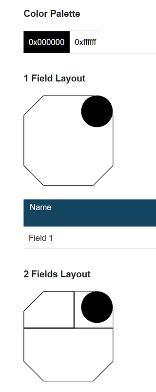

    Further context, I went back and retested instinct3solar45mm in the sim (which has a subscreen).
    - 1-field layout indeed covers the entire display (including the subscreen)
    - 2-field layout excludes the subscreen
    It looks exactly as in the device reference guide:

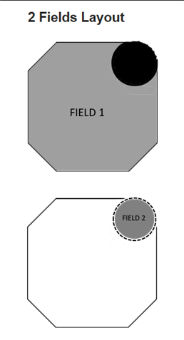

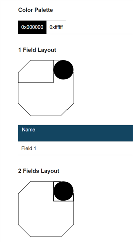

  • Imo the existing diagrams in the device reference guide are very unclear, where a subscreen is involved, so I added some mockups to the bug report that I think would be improvements. I'll also post them here.
    What I think could be done to improve these diagrams:
    - In all cases, assign numbers to the individual fields, indicating their order in the data page
    - Shade the areas of the screen which are assigned to fields
    - When there's a device with a subscreen, and it's ambiguous as to which areas of the screen are actually assigned to fields and/or fields can overlap, have a separate diagram for each field.
    e.g. Instinct 2
    1-field layout (assuming it actually exists)
    2-field layout:
    or maybe:
    e.g. Instinct 3 Solar:
