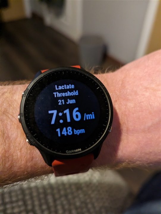

I did an interval session today after deleting the running hr settings from the watch. For the first time since September I got a change in VO2max and a point on the gc graph for lactate threshold (unchanged, but a dot on the graph). However, the watch value for lactate threshold has not updated, and still shows the same value and a date of June 21st
Does your watch show today's lactate date?
No. Still showing June last year!
