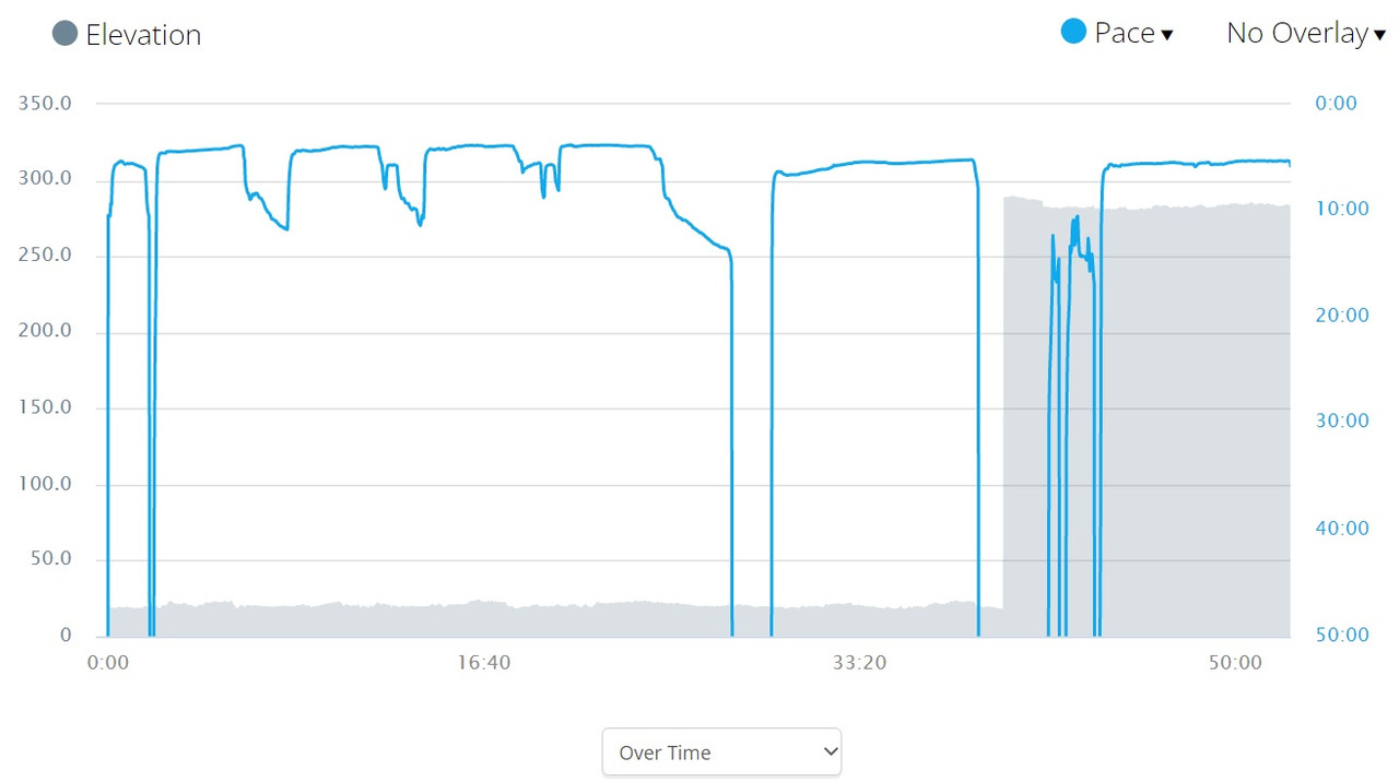

I use ForeRunner 745 and I noticed that for the past 2-3 weeks, unless I'm doing an absolutely flat run (along the beach), during each of the training sessions there is a moment when the altitude suddenly drops 30-100m and then it stays there and it's wrong so I have to recalibrate. I have Auto Calibration on and sensor is set to Auto.
I run with a friend who uses Fenix 6 with the identical settings and there are no problems with their device.
Is that normal? Expected? What should I try to fix it?
  • this one is from my yesterday's run, with an altitude drop from 100m to 81m
    https://ibb.co/S3Q10C3

  • Hi @lucas435, that question you asked a couple of weeks ago made me go through all the activities I did in the past few months. Another interesting thing I found out, although it sounds like more of a coincidence rather than scientific proof, is that the large majority of elevation drops/jumps occur right after any type of watch alert:
    • - an upcoming Strava segment
    • - run lap alert
    • - custom run alerts based on time and distance (e.g. in my case these are hydration every 5k or a gel every 45 min)
    • - performance status alert
    It would be interesting to find out if any other user can confirm that theory.
