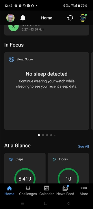

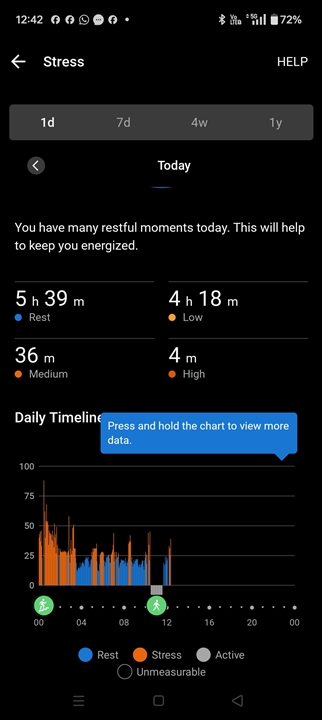

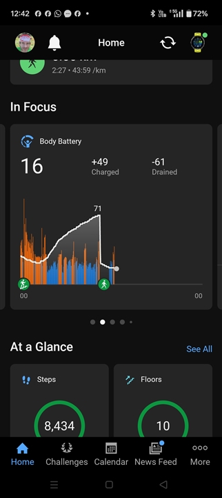

  • 1. yes
    2. Well it depends, it's 22-08 and the actual sleep was 2:00-10:21. I am not very good in sleeping at the time I set on the watch, but this is the 1st time I actually slept, slept good and long, started to sleep inside the window and it wasn't detected.
    3. Yes
    4. Yes
    fr965, FW: 21.19
    As you can see it's clearly visible that HR is on (24/7) and both body battery and stress detected I was resting. I really don't know why it didn't register sleep. Usually the opposite happens: I watch a movie (so I hardly move) and it thinks I was sleeping.

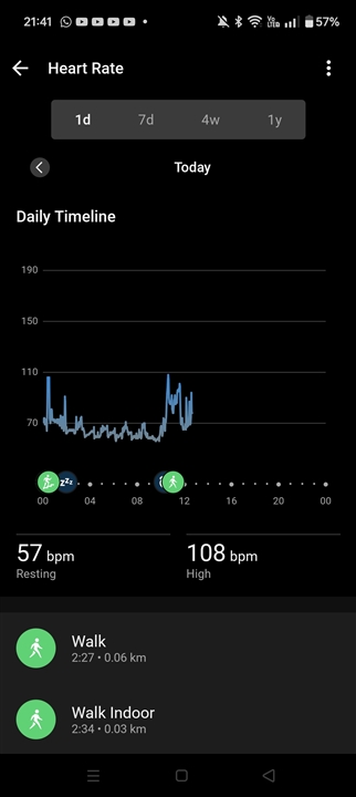

  • Even with the latest 22.14 (FR965), I'm intermittently getting this.  No sleep detected at night.
    When I go into the data- my HR is shown all night to be lower than reality (in the mid 30's, whereas my resting HR is usually upper 40's), there is no HRV or Stress recorded.  if I restart my watch, the HR begins reading accurately again.
