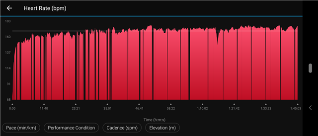

When recording activities with my Forerunner 245 Music together with a Wahoo Tickr heart rate chest strap I've recently noticed issues with recorded heart rate measurements. At a first glance it looked like intermittent drops but after checking further there seems to be a pattern to it.
From what I can tell pulse recording is paused whenever a notification is shown on the watch. On a normal run I get periodic pulse dropout on every km notification.
I tried following a route and had plenty of off track notifications in the beginning of the recording. That recording looks much worse and strengthens that it's related to notifications shown.

    Yes that second picture is from a long run where I choose to follow a course via: Run->Options->Courses->...->Do course.
    I received plenty of route notifications until I after about 1h choose to go completely off track and the watch stopped guiding me. This pattern of notifications received  is quite visible in the recorded heart rate graph. So yes I believe all these gaps are due to notifications shown.
