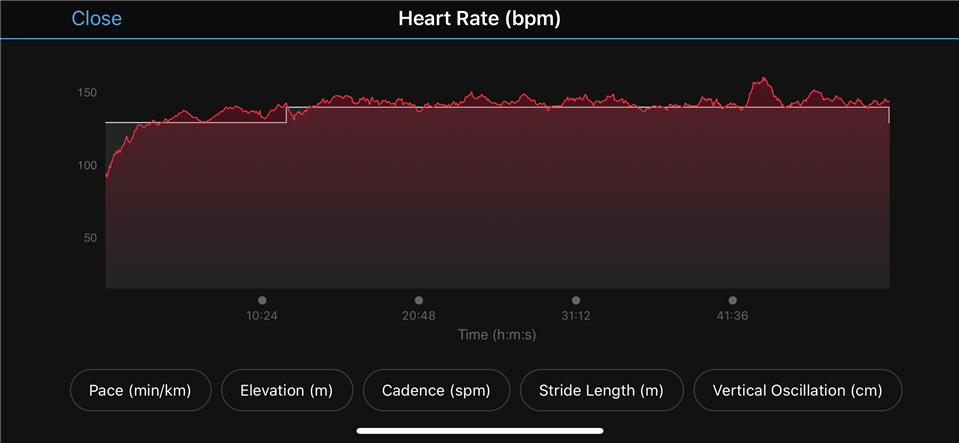

It seems like the connection interrupts and the 245M gets the data from my wirst until it reconnects again (during a run).
The HR drops from 150 bpm to 125 and then back to 150 for example. Anyone facing these issues as well?
