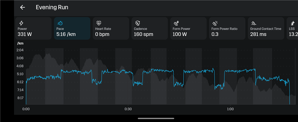

  • I did yesterday my run and I can tell you that pace was very stable but to high comparing to average pace.
    Distance also deffer from other runs I did on the same track with GPS measure.
    I’musing now Fenix 7X sapphire and couple days ago I did the same run, yesterday on the same course but distance measure set to HRM-Pro I got the same distance (5,21km), 300 m  further than first time. It is around 6% difference.
    I will continue to run wit autocalibration, also planning to do some sessions on treadmill and after that will repeate this run to see what will change.

  • The autocalibration is way off for me.
    Run yesterday with HRM Pro still set to autocalibrate (8+ hours of runs in). The pace and distance was way off. Total distance 5,75km (short compared to previous runs with GPS only and with stryde).
    Today run exactly the same course (HRM Pro with autocalibration but after resetting the data). Total distance 6,8 km.
    This is a little confusing. Not sure if yesterday my HRP Pro was still calibrating or the autocalibration process was already done. This is the second time I got the total distance short and have to erase the autocalibration data.
