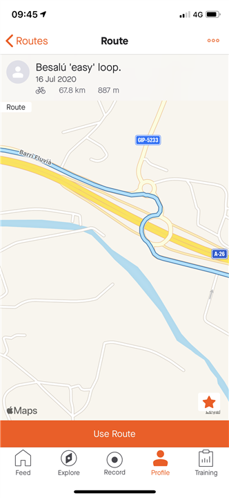

  • I am having a similar issue but I’ve traced it back to strava routes. I’m in Spain and plotted several rides and for roundabouts it seems me quite dangerously the wrong way round!!!
    During the rides I thought maybe there was a footpath the Marris we’re getting confused with but after passing a few roundabouts it was clear there was none.
    Here’s a few examples taken from a strava route.
    This is a recurring issue in several routes.
