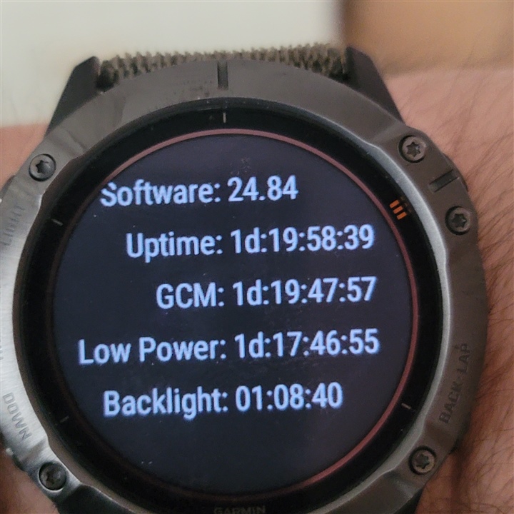

  • My watch has dropped exactly 20% since charging to 80% just 44 hours ago, so less than two full days.
    I have only recorded a single activity of Virtual Run, which lasted 50 minutes.
    This is on 24.84b.
    Even before recording the Virtual Run this morning the watch had lost 17% upon waking, so it is draining rapidly simply in smartwatch mode, regardless of activity recording.
