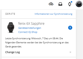

Today it showed-up in GC as available:
Did WIFI-sync and it downloaded, but no notification about it. Applied via system settings - done, sensor hub 22.09.
