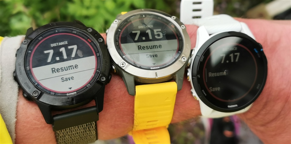

  • I have done 1000s of miles with a Fenix 6 Pro and other watches and i just do not see short distsnces from the F6 Pro (usually within 0.02 or 30 meters)
    If people are seeing massive distance under reporting it feels like a faulty device to me, especially when people are talking about 20% errors.

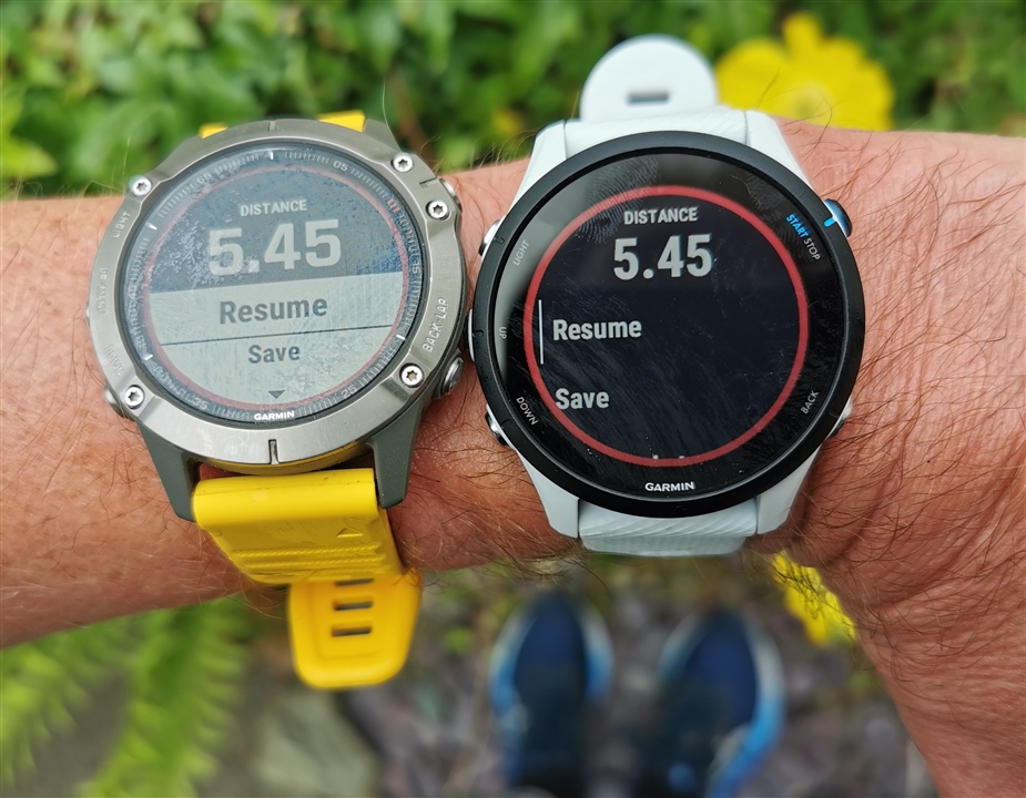

    Interestingly though when I run with my brother-in-law my distances are longer than his - my F6 and F7 agree very closely, but he comes up shorter by about 1% when we are side by side.

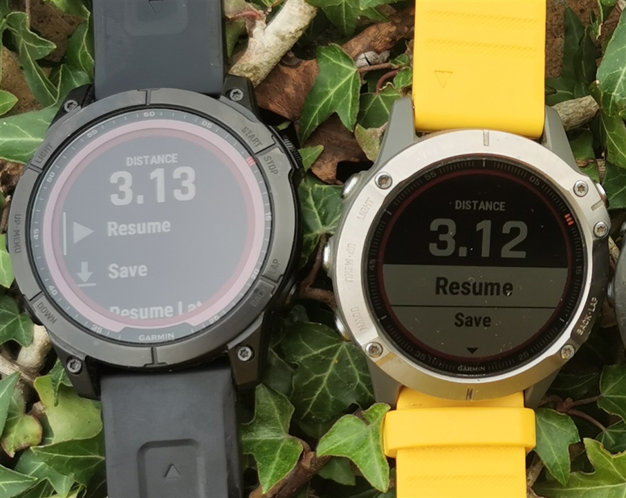

    The parkrun there has 700 feet of elevation over 5k and I always measure about 3.11-3.13 - never short. It's basically impossible to run it short (or long) as these are super narrow paths often not more than 3 feet wide.

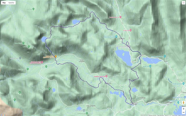

    I've have not observed this - this run is from the Maverick Adidas Terrex 25k run in Grasmere, UK and the tracks from both the Fenix 6 and Fenix 7 are basically identical with only 0.04 miles difference between both devices.
    The GPS tracks are so close, in the overview is just looks like one device

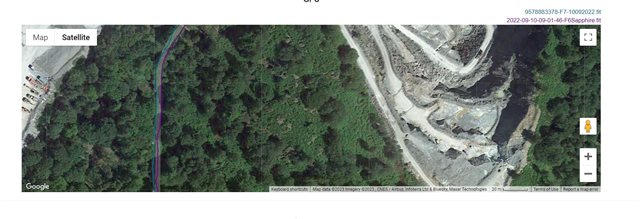

    And zooming into the track under tree cover...

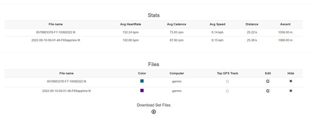

    Distance recorded from both...only 60 meters (0.04 difference) - and the Fenix 6 is actually 0.04 miles LONGER here!
