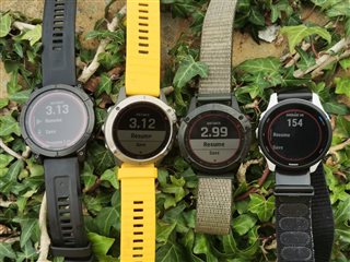

So,,,drum roll here are the results after a measured 5k run. First 1 1/2 miles were at an easy 8:30 /mi pace, then I held 7:30/mi for a mile, moving to 6:30/mi. When speed was around 8:30/mi distances matches closely, but as I speeded up, the footpods (Stryd and HRM Pro) started loosing distance
4 watches - two used GPS - the Fenix 7 and Fenix 6 Sapphire
the black Fenix 6 Pro used the HRM Pro for pace / distamce
The Forerunner 255 used Stryd for pace and distande
Results: (two pics as the post run summary pages never were always in sync)
Final Measurement
F7 - 3.13 miles (+30 meters over actual)
F6 Sapphire 3.12 miles (+15 meters over actual)
Forerunner 255 with Sryd - 3.05 miles (-96 meters under actual)
F6 Pro using HRM Pro 2 2.99 miles (-193 meters under actual).
The most accurate watch for distance was the F6 Pro Sapphire, followed very closely by the Fenix 7. Worse results by quite a way using HRM Pro, followed by Stryd- obviously if the distance is too short, it means the pace is also wrong....
Note: Generally I do not have an issue with GPS accuracy, so your mileage may vary
Note2: Stryd is generally quite accurate when using a calibration factor - for this test I chose not to calibrate so everything was as fair as I could make it.
