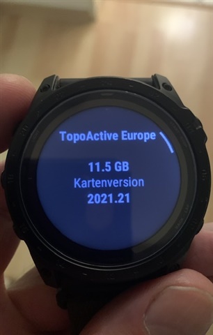

Unable to load / install TopoActive Europe v2021.20
I just received refrubrished unit, got new one- and not being able to use it - because i got no maps.

Tried all people suggested here, removing, reinstalling express, pretty much everything - and nothing works .
Only after full reinstall Express & full wipe Fenix 6 i was able to install few maps - but it crushes on Topo Europe ;(
Based on this post : https://forums.garmin.com/outdoor-recreation/outdoor-recreation/f/fenix-6-series/172511/installing-maps-on-fenix-6-fails#pifragment-1292=8
I ended up with Support team - and they were not able yet to find solution.
I have different maps on Watch, Different maps on Express & Different maps to be updated on Express
Receiving replacement of watch meant to fix my battery issue - i ended up spending my time on solving yet another issue (as battery in Bike mode is still crap - 5% per 30 minutes no matter whihc settings & sensors)
Sent all files and waiting for Garmin to get back to me.
European maps are quite big. Are you sure you have enough space on your computer? I think you will need around 15gb on your computer's main hard drive.
I was surprised that this was mentioned in many posts & documentations & and also by Spport team. - that means people not aware of that to begin with - it was clear to me that you need space for update - but this is clearly some issue with refrub watch rather than anything else.
Thanks for checking that - i do have enought space on both Watch & PC.

My issue might be on Gamin side - as i see different maps in different places. Waiting for Gaming to get back to me.
