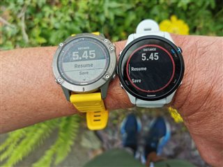

I have been running on the same field for years. According to Google Maps the lap distance as I run it is about 334 meters:
Garmin Vivoactive 4 that I used for 2 years measured the same lap distance at around 320 meters, which I consider quite acceptable measurement. Now I upgraded to Garmin Fenix 6 Pro and it measures the same lap distance at 280 meters! I have used even an Honor Band that costs 30 Euros and it measures the distance closer to the 334 meters that it is indeed, same with applications like Huawei Health using iPhone GPS.
From watch settings, "Run Settings"/GPS I have used GPS+GLONASS and GPS Only, same result. Latest updates are installed on my watch.
Has anybody faced the same issue? Any suggestions?
