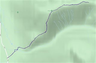

    I was able to reproduce this today on an ascent up Whiteside East Top starting at Lanthwaite Green. I see the jagged steps in my hiking track - its a slow ascent and a scramble in places and first time I ever saw it.

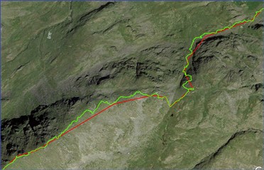

    I also recorded with a Coros Pace 2 at the same time - too be honest, I think I see the straight lines there too - same Sony chipset. So I think it's Sony being weird, not Garmin doing something 'odd'
    Garmin in purple, Coros Pace 2 in light blue zoomed in
