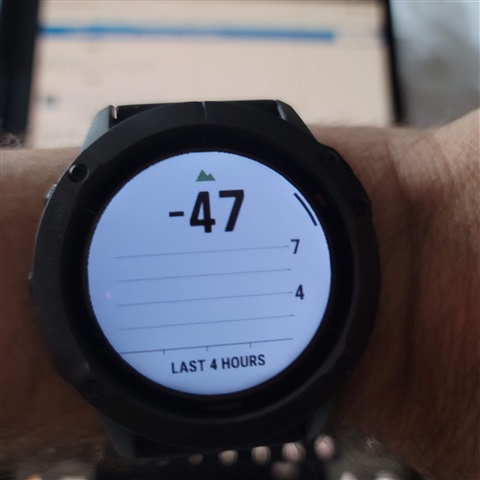

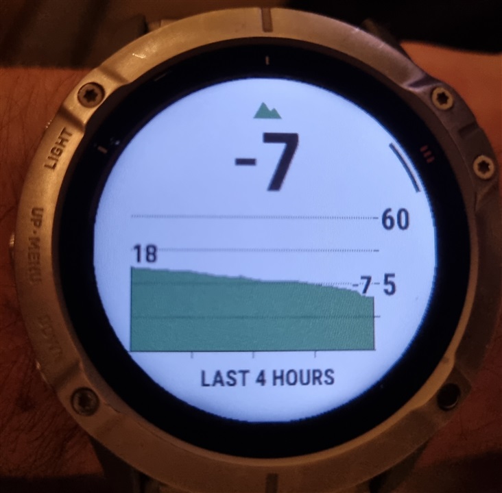

  • Altimeter fail.....
    Last night before going up to bed I deliberately set the altimeter to +1,000m to see how it adjusted overnight. This morning the altimeter showed -47m.
    Correct altitude for the watch is presently +47m, with ground level and DEM at +43m. I don't know what possessed the watch to start digging a hole last night.
    There is also an empty history graph.

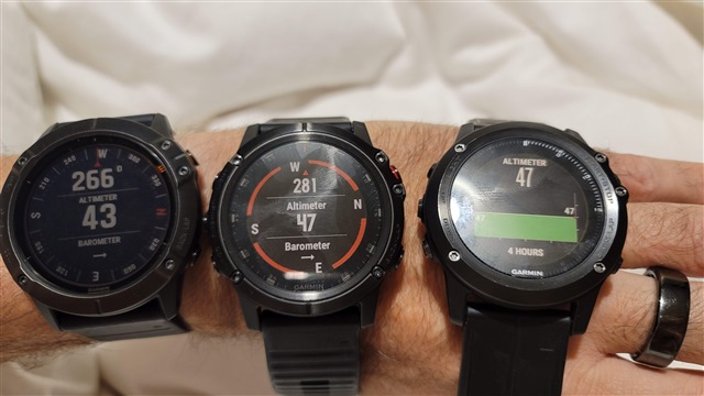

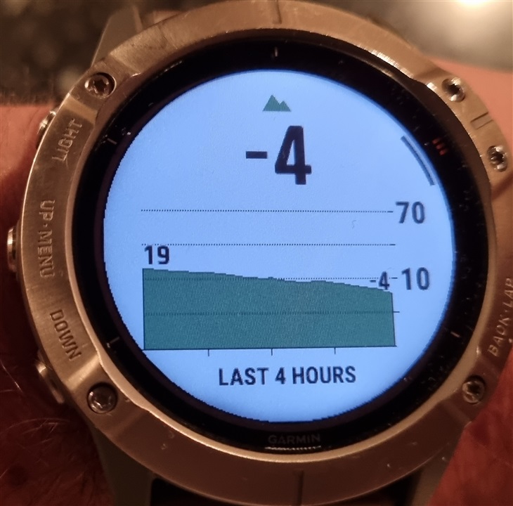

  • Altimeter is back to its broken overnight ways again it seems. Went to bed with the altitude showing approximately the correct figure, woken up this morning and it's climbed 40m overnight.
    I'm not really sure what has prompted the change in these betas, was it completely broken in the release firmware also? (can't say I ever noticed)
