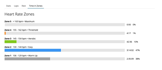

  • That's a thought - in GC Web, for the activity what does it show in "Time in Zones"
    For example, my saturday ultra in 19.2
  • Oh and in Settings/User Profiles/heart rate - double check there as well for RHR, Max HR etc
  • No, seems to he a spread of zones. Have changed the zones in each activity and resynced, then changed back but based on the above it is recognising the zones just not correctly calculating the load etc.
