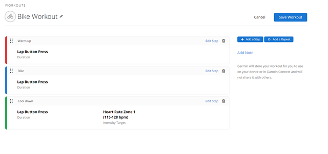

Thanks. Found it. Not very intuitive. I wish the manual would mention that. Now if I do a 45 mn cycling workout with the last 5 mn as a cooldown, should I still do the cooldown or stop the workout when my hr is high?
If cooldown is part of your training (still cycling) I would let the timer run, or even create a workout where lap button transfer you to next stage. You can also set a target (power, hr, time etc. for the cool down):
thanks. i learn something today. will work on that.
