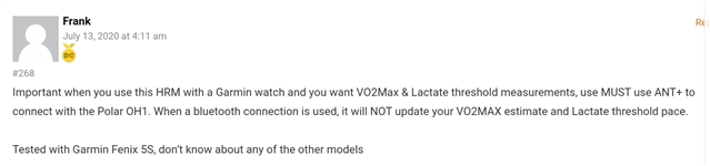

  • From a comment to the DCRainmaker review of the OH1 there is this interesting observation....
    Review here - https://www.dcrainmaker.com/2019/03/polar-oh1-plus-optical-hr-sensor-in-depth-review.html
    I think that some devices are fussy about whether you use ANT+ or Bluetooth when it comes to certain features such as R-R or HRV data and assessment of performance from that data, which might only be supported by one connection type, but not both.
    Since Garmin owns ANT+ I am not surprised that they might favour that connection type. Even Stryd recommends ANT+ for connection to Garmin watches and actively discourages use of Bluetooth, even though it is supported by Stryd and Garmin.
  • Very weird! Especially that I have been only using bluetooth for the last year and my VO2 Max and LT have both changed in that time! but great find there :) I wonder if the update forces this now... I just found ANT+ so flaky - works ok if worn on the same arm as watch but drops out when on opposite arm to the watch.... I will continue with ANT+ in that case as using the wrist based HR is a no for training... I would love for Garmin to adopt teh Polar HR technology, the Vantage V was the most accurate wrist based HR I've ever experienced, the software just wasn't at Garmin's level though!
