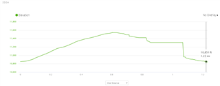

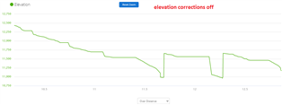

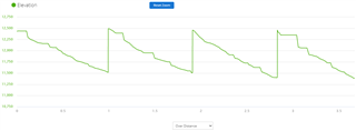

I'm still seeing huge misses on elevation with the backcountry ski activity. Usually this happens on the way up, but today it happened on the way down. It registers zero descent and then suddenly corrects, creating plateaus and cliffs in the graph. There are plenty of (accurate) GPS data points in that portion of the activity that follow my track closely, but the elevation registers no change for a long time.
Notes:
  • Altimeter > Auto Cal > During Activity > Continuous
  • Baro Watch Mode set to "Auto"
  • The watch is covered by a glove and wind is definitely not impinging the barometer port.
  • The runs vary from 20 to 45 mph and it happens seemingly at all speeds
  • SW is v16.00 RC

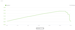

  • Tried again, the bug persists:
    It's possible this is because I'm pausing and resuming the activity at the top, but the GPS trace is flawless and for the altimeter to be this erroneous is very suspicious. Maybe it's not handling rapid decreases in elevation (skiing) properly.
  • Error is reproducible in Ski activity, and shows up over dozens of runs, with grossly incorrect elevation profiles at all times. GPS remains accurate and turning elevation corrections on (using terrain elevation map and throwing out the watch's elevation data) shows a vastly different profile

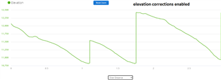

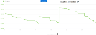

    Compare these two images without and with elevation corrections on:
    In order to give such a smooth curve with elevation corrections on, the GPS has lots of data points to check against the terrain map. This is definitely not a GPS error, it's an altimeter/auto cal error. My guess is that the altimeter was not adequately tested with the higher speeds and rapid elevation changes that are seen in skiing, so it throws out the data and only updates against the DEM when stopped or at longer intervals.

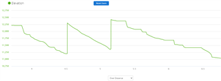

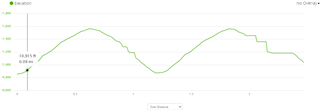

  • Ok, today I tried with baro watch mode changed from "auto" to "altimeter":
    this is the altimeter output without any terrain-based elevation corrections in Connect:
    now see how the profile is supposed to look with elevation corrections turned on:
    Baro watch mode has no difference in accuracy during descent, and introduces other problems as far as I can tell, also.
    Let's check out Backcountry Ski with the same settings (altimeter instead of auto). Same problem:
    Again, the GPS is precise enough during this time to even correctly show which side of the run I'm on, with very fine data points. I can even see some of the larger turns I made on the way down. GPS has accurate data, yet the elevation profile is junk.
