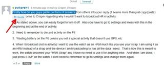

    1.  For 24 hour HR I don't think they should force anything, simply make it user selectable, like 1 sec recording vs smart recording.
    2.  Both broadcasting modes are used while doing activities so both need to be accurate.  I think you missed my point that some simply choose to use the watch as an OHR instead of a strap and are PERFECTLY OKAY not having the ability to use the watch for other modes, it simply becomes a dumb HRM much like the strap it replaced. (but not SO DUMB that it produces sub-par accuracy)
