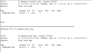

    one more ... check your gmaptz.img in the GARMIN folder
    • replace with this one and upload yours here zipped Slight smile
    • gmaptz.zip

    4861.gmaptz.zip
    Here is my gmaptz. What is the purpose of this file? Copied you file to my watch.

    gmaptz.img corrects time linked to different time zones
    file looks ok, both compared
