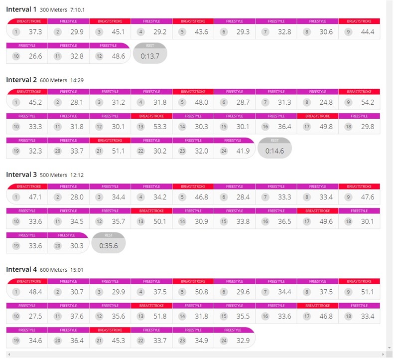

  • I thought I'd never seen this issue before and I often start my pool swim intervals with breaststroke, before switching to front crawl.  So I confirmed this morning, with my 6X Pro Solar on 5.72 beta, I'm simply not seeing this issue.  I have my reasons for not wanting to make my Connect links public at the moment, but the screen shots of my swim this morning clearly show every Interval starting with breaststroke and the stroke type has been correctly detected after that for every length through the whole swim (after my warmup of a few alternate breaststroke/front crawl lengths, I settle in to rotating through one length breaststroke then 3 lengths front crawl).
    I can't explain why you have the issue you describe when starting an interval with breaststroke, but it clearly isn't an issue impacting everyone.
