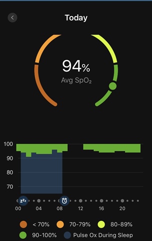

    I have PulseOX 24/7 enabled, backlighting off, charged to 100%, DND set between sleep & wake times, let's see how it fares the night. I will wear my AW3 on the other hand to check in the morning how the sleep stages/detection and HR/RHR rates compare. For AW3 i use Autosleep which has been very accurate over the months of use.
    I love the floors climbed/descended feature, but isn't it possible to see when actually a floor was climbed/descended? For some reason i have 7 climbed / 6 descended which doesn't make sense...can't we see the individual values and edit/delete them if we know they're wrong?

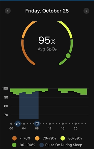

  • OK, night has passed. Almost 12 hrs since i charged to 100%, now is at 87%. Right now it seems that a full 24h will eat more juice than the Venu (which ate ~20% / 24h) with the same settings: HR+PulseOX 24/7, no notifications, backlight off, smart sensor recording.

    So, after 48h i have 45% battery left. PulseOX measurements on 24/7, no notifications, backlight gesture OFF, backlight brightness 20% (comes on when touching the display), NoFrills watchface.

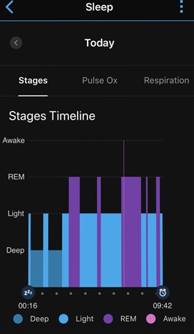

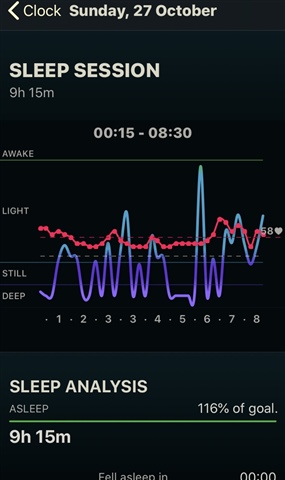

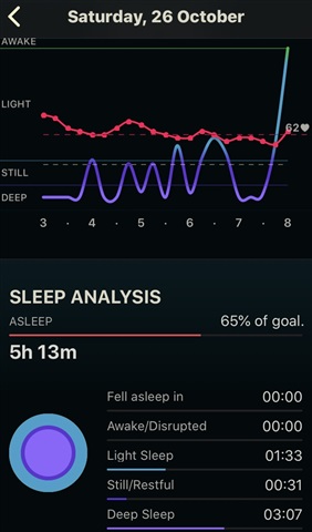

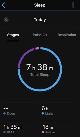

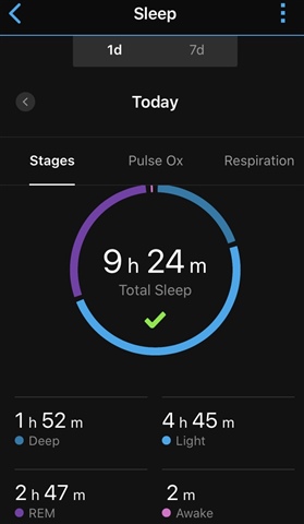

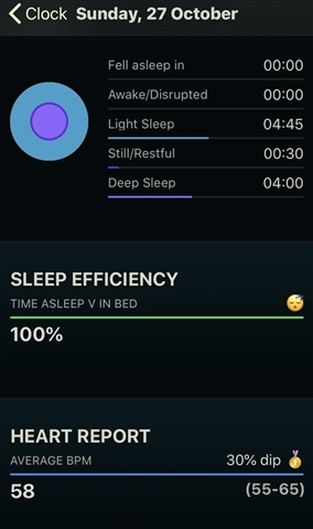

  • More sleep analysis comparison
    Left AW3 with Autosleep
    Middle & right VA4
    Overall i'd say timing is very good, light sleep detection very good, but loses/mixes some deep sleep with REM

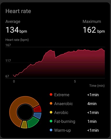

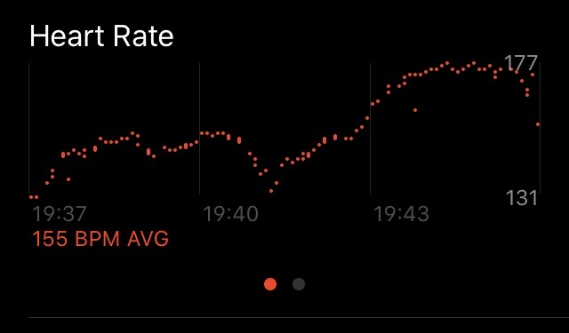

    This was a close one, at least from HR measurement under water point of view.....

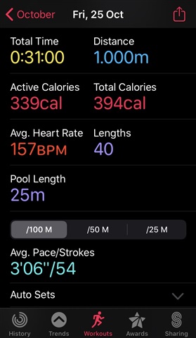

    From left to right: Apple Watch 3, Huawei Watch GT2, Garmin Vivoactive 4
    I will focus on laps, distance and HR.
    Pace, SWOLF are useless since we need a clean baseline for all 3 devices (proper detection of laps, distance, times) to start with.
    For fun you can however compare AW3 and GT2 values for pace, SWOLF. The only thing that VA4 kept up with was...keeping the time of the workout Slight smile

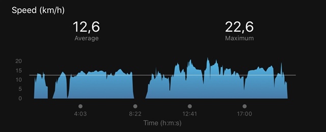

    1000m (40x25m) SESSION DETAILS
    Did 30 freestyle + 10 breaststroke in total
    Started freestyle then switched at some point, can't remember didn't keep exact track

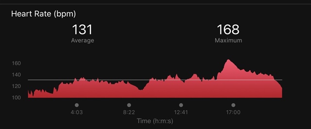

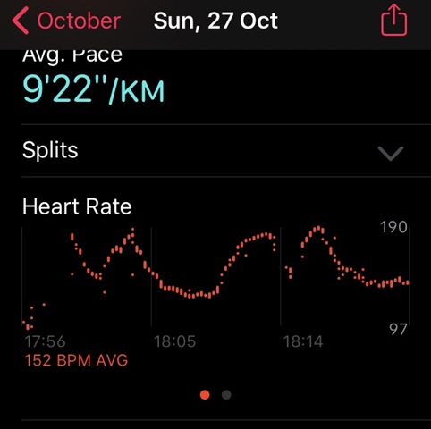

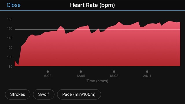

    40x25m HEART RATE DETAILS

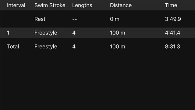

    250m (10x25m) session -> started with 6 breaststroke + 4 freestyle
    10x25m (6 BREASTSTROKE + 4 FREESTYLE) HR DETAILS
    BREAKDOWN OF LAST 250M (10x25m) from Garmin Connect.
    You can see clearly that the first 6 weren't counted/detected. It picked up only the last 4 freestyle.
    I rested for 3:49....really?

    - HR detection underwater for all 3 devices is very close. VA4 seems to go a bit higher post-workout, whereas GT2 and AW3 are identical (no joking)

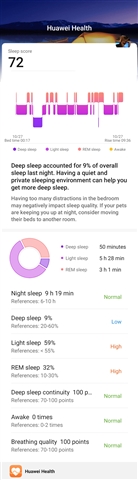

    PS - tomorrow a sleep analysis comparison between the 3 contenders will be done.

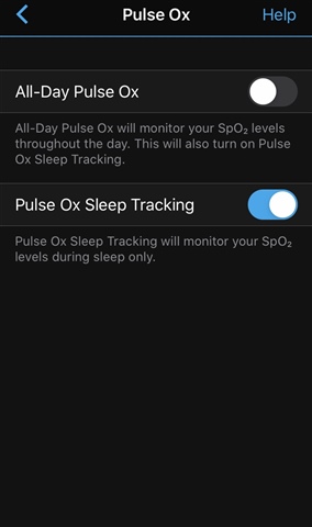

    Battery on VA4 down to 15% after 3 days. Today i disabled 24/7 Pulse OX and left only during sleep enabled. But i still see SpO2 values being read during the day, as if the setting didn't apply. And yes, the watch was sync-ed several times since.
