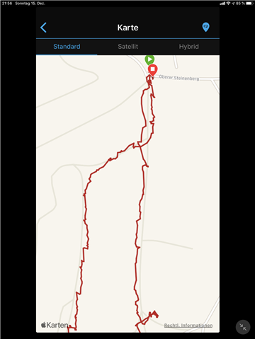

I am wondering the F6 performance dips when the battery is low. I have a 14 hours left and did a run. The GPS route is terrible. It has been through ponds and shrinks the run down massively. The black line is the route. I have the google gps  map too and it's no better.
Is the overall distance based on the gps data as my 4 laps are quite a bit shorter than the reality. Is anyone else having gps issues?
I really felt the F6 was the ultimate outdoor watch but I am a disappointed at the minute, especially given the investment.

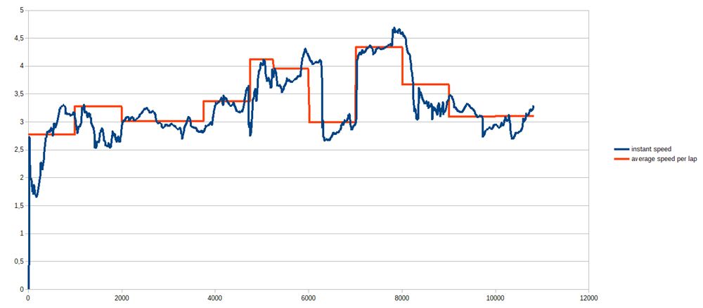

    We are facing the same issue. I wrote once again to US support (French support did not even answer to my questions) with 7 files in example, where I plot instant speed and average speed per circuit against distance. one example below. I will keep you informed if there is any update / feedback...
    km 1 to km2 is a good example, but same for km4 to km5.

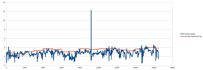

    and maybe worst :

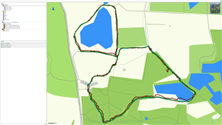

  • This is 6X Pro Solar vs V800 vs 5X+. The 5X+ is the drunk route. 6X and V800 are very close indeed. Impossible to say which is more correct, but both are good. 5X+ is just embarrassing.
  • The red track color is fenix 6x?

  • No, RED is 5X+. If you click to enlarge the photo you can see the key on the left. 6X is CYAN (light blue). V800 is GREEN.

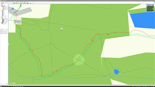

    The whole track is about 3.3 km and includes open areas and leafless woodland. Here is a close-up of the woodland area. I did not walk the little loops of the red line from the 5X+...
  • That's interesting. I also thought that the red line was Fenix 6 and that you walked both circles counter-clockwise. That is what I would expect from my Fenix 6.
    In my case it's like pamarunkov said: It's always shifted to left in the direction of movement.
