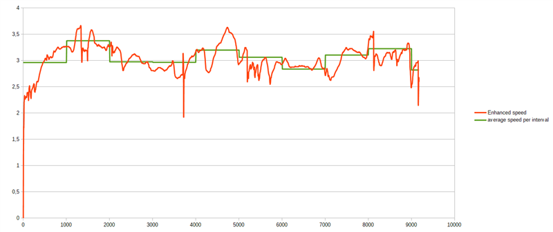

    Nevertheless I did some other checks, and even against distance, it doesn't work. Like 2464285, I quite often have an average pace on 1 km (autolap) better than any pace i've  seen during this lap.
    i plotted the instant speed (M/S, in red) from FIT file, available for every second, against distance (X axis) and the average speed given by the Fenix 6 for each kilometer (in green, data from FIT file as well).
    we clearly see that for between km 5 and 6, i was almost always slower than the average speed for this kilometer, same for km 8 to 9, or 7 to 8. Only km 6 to 7 seems to be a little bit in the other side.
    and this is one of the most consistent pace / speed that i've seen since I started using this watch about 2 months ago.
  • That is true and it was my first thought as well, I did a check in GC web and changed to distance on X axis and it looks better. BUT, the FIT file records speed at every second as m/s. It is obvious that the average you get in the end from the FIT file for pace differs quite a bit from the average the whole activity.
    I think that the reason is that for instant pace they have to calculate it every second based on GPS data but for average they can store GPS data over time and apply error correction which in the end will give a more accurate distance and a more accurate speed/pace.

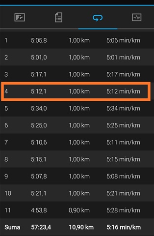

    After update to firmware 5.00 no change. Again for a full kilometer current pace indication was 5:40-6: 30 and even 7: 20min / km never once below 5:30 and the average pace after kilometer 4:59. How it's possible? As I mentioned in the previous post, my 5-year-old suunto ambit 2 gives the current pace without deviations greater than 5 seconds (1 sec gps mode). So I don't understand why garmin engineers can't handle it.

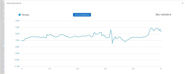

    Yesterday's training. Pace shown by watch and recorded between 3 and 4 km of my run. You can see that recorded pace was like 6:00 - 7:00 min/km and faster for some time. And again I know tand felt that real pace was like 5:15.
    And pace after 1 km autolap was measeured correctly.
